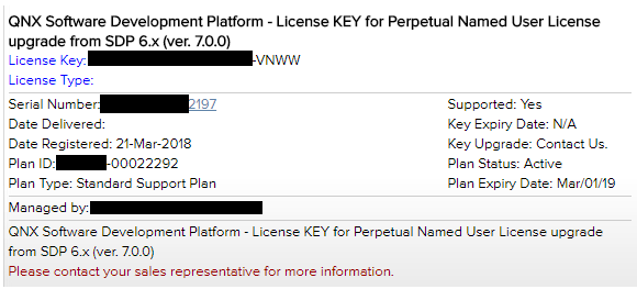

Re: QNX7 Installation failure
Hi Mike,
I have a license that expires until March 2019. Will it matter if someone else downloaded QNX Software Center for me?
The way I see it, the problem is that QNX server is blocking my access to the files.
I have attached a screenshot of my license.
Attachment: Image QNX_license.png 18.92 KB
