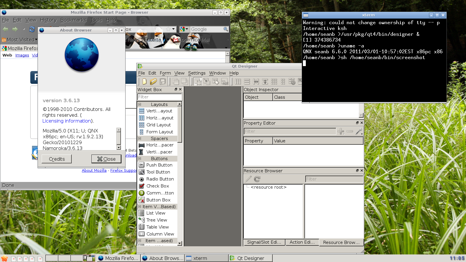

On the other hand, Qt support is all there for QNX 6.6. The effort migrating to QNX 6 will be indefinitely lower than
trying to get Qt running on QNX4. Face it, QNX4 is as old as Windows 3.11!
