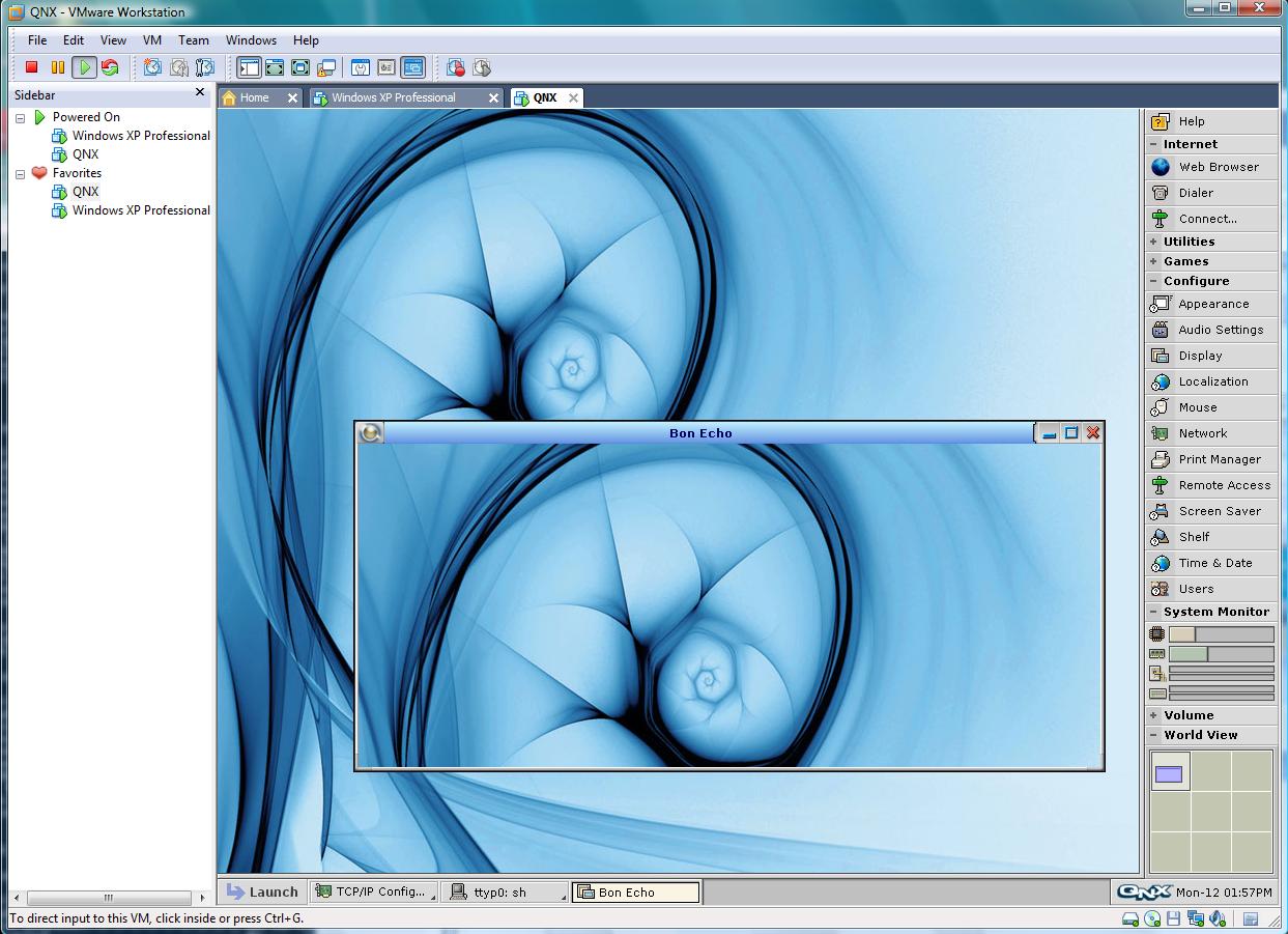

I have a strange error in QNX. I'm running QNX in vmware workstation 7.
When I try to start the webbrowser it tries to open for a few seconds and then it says on the title bar "Problem loading
 page - Bon Echo" and the window is transparent so you can see QNX:s background through the webbrowser and there is no
menus.
So, how do I start the webbrowser? why does it not work out of the box?
You can see my attachment to see how it looks.
BR
JJ
Attachment: Image qnx_snapshot.jpg 145.96 KB

The new VMware changed some things w.r.t to graphics.  The new vmware driver in the upcoming 6.5 will address that issue
