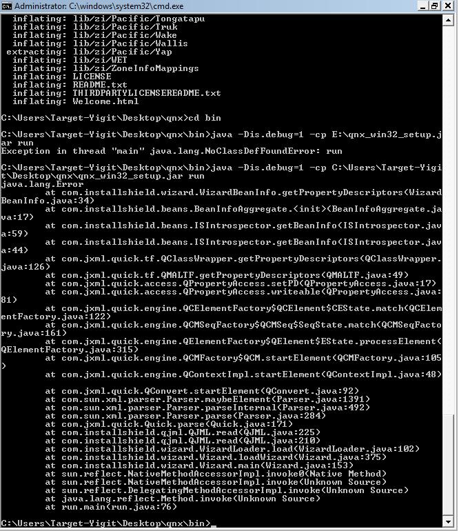

Try re-installing QNX SDP 6.4.1 using the workaround (NOTE the last command now has a debug option):
- copy qnxsdp-6.4.1-nnnnnnn-win32.exe to a new folder
- run these commands (without the quotes)
"qnxsdp-6.4.1-nnnnnnn-win32.exe -is:extract"
"windows-sun-1.5.0.exe"
"cd bin"
"java -Dis.debug=1 -cp D:\qnx_win32_setup.jar run"
The log file is being updated with every installation attempt, so if there are any issues, please post the log as well
as the console ouput that will be printed out once you launch the installer with the debug option.

This is the log from is.debug,

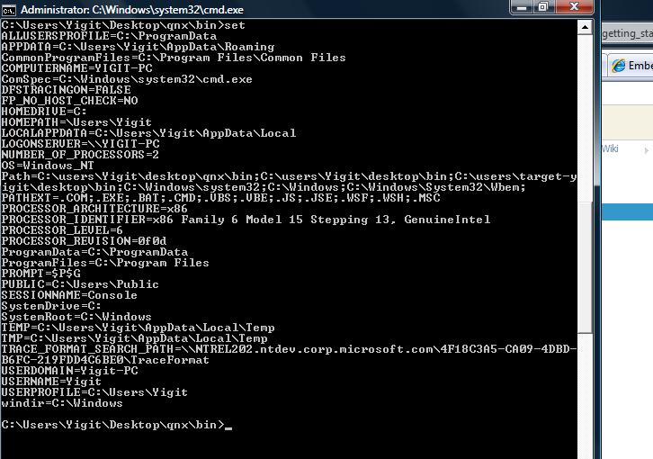

Yigit, can you post all of your environment variables and their values, i.e. the output of command "set"?

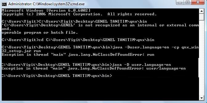

Also, when you're in "c:\users\target-yigit\desktop\qnx\bin" directory, can you type " java -version" and post the
output of that command, please?
My last suggestion would be to set your PATH variable to start with "c:\users\target-yigit\desktop\qnx\bin" and then
launching the installer using the workaround.
To set the path:
set PATH=c:\users\target-yigit\desktop\qnx\bin;%PATH%
Natalia

After setting PATH as you described, it returns ;
java version "1.6.0_14"
Java(TM) SE Runtime Environment (build 1.6.0_14-b08)
Java HotSpot(TM) Client VM (build 14.0-b16, mixed mode, sharing)
on everywhere else except the bin folder where it results in,
java version "1.5.0"
Java(TM) 2 Runtime Environment, Standard Edition (build 1.5.0-b64)
Java HotSpot(TM) Client VM (build 1.5.0-b64, mixed mode, sharing)
The result of the SET command is attached...

> - Windows Xp Pro Service Pack 3
> - English Operating System.
> - I followed your instruction that tells to go cmd Screen to install right
> Java Version, but I failed. Because it gives an error called as below;
> Exception in thread "main" java.lang.NoClassDefFoundError:
> - I also visited Oracle web site to download right Java Version, Although I
> downloaded latest release, I got the same error, "No debug found" for QNX 6.4.
> 1.
> Now I kindly ask you, what is the reason which doesn't allow me to install QNX
> 6.4.1?
> Can you send me right link of Java Version. I am looking forward to your
> helpful answers.
> Regards,

Dear Natalia,
I have read your all post about this subject but nothing chages. I just don't understand why it doesn't allow me to
install it. By the way, I am from Turkey. Maybe our OS are bad, not good as in Canada or USA. I have no idea what I am
going to do.
1. I copied qnx.6.4.1 into a folder and I called it Java. This folder located on Desktop.
2. Then I did what you said to me. But again, same error which can be seen as below.
C:\Documents and Settings\Target Teknoloji\Desktop\Java\bin>java -Dis.debug=1 -cp C:\Documents and Settings\Target
Teknoloji\Desktop\Java\qnx_win32_setup.jar
Exception in thread "main" java.lang.NoClassDefFoundError: and
I am looking forward if you have any other suggesion.
Try:
-Dis.debug=1 -cp "C:\Documents and Settings\Target
Teknoloji\Desktop\Java\qnx_win32_setup.jar"
(note quotation marks around the path to qnx_win32_setup.jar)

11/20/2009 9:28 AM
post42308
Hello Natalia,
Please know that i appreciate your efforts.
This week was very busy and i tried your suggestion as soon as the dust settled but i get the attached screen.
Thank you for trying to solve this issue.
Regards
yigit
11/20/2009 9:38 AM
post42309
Hi Yigit,
There is a typo in the command that you ran - please note there should be no space in "-Duser.language=en" :
bin\java -Duser.language=en -cp qnx_win32_setup.jar run
Natalia
> Hello Natalia,
> Regards
> yigit
11/20/2009 10:06 AM
post42312
Corrected version, still the same output.
