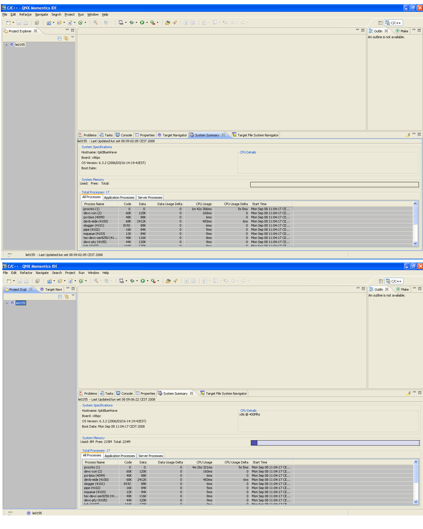

Re: 6.3.2 Sw updates error...
In attached image two screenshots of IDE, the first not working the second one working.
The IDE is TAU 4.5 version I've installed few days ago.
The workspace has been created by IDE the first time I started it; in not working set the Target Navigator has been set
by ide via Window->showView -> Target Navigator.
Then I moved Target Navitagor in the left pane (see second screen shot in the image) and left pane and memory info
apperaed.
With Widnow ->reset perspective and then adding target navigator and system informatnio again, memory info appears
immedaitely leaving target navigator in the bottom pane where IDE creates it.
Hope this help...
bye
Max
You are not in the System Information perspective. You should switch to it when using its views. Once you switch to it,
do a reset perspective to put those views in their default location. I guess that's the root cause of your original
problem.
