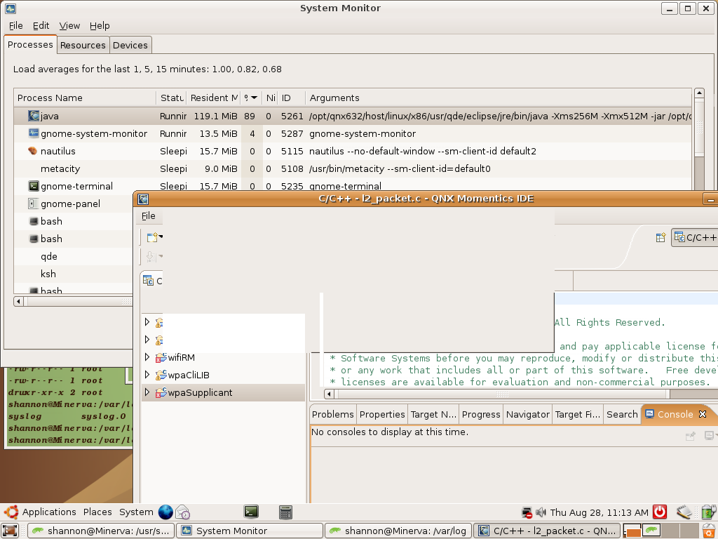

In both system (XP and Linux) the CPU was occupied by QDE up to more than 90%, it will eventually run through, but one
click will take a few minutes -- which is very frustrating;
But this is only to QDE itself, so if I shut down the process, every thing goes back to normal.
I attached some screen shots running QDE from my Linux laptop, the 1st one is when I right click one of the project name
, and you can see the process start to run; the 2nd is the program is still in the middle of the it and trying to
response, and when you check the clock at the bottom of the screen -- it has been 2 minutes already;
I'd appreciate any input regarding this.
Thanks a lot for your prompt response.
Shannon

Re: RE: QNX Momentics suddenly slow!
First of all, nothing was updated or upgraded, all the changes are project wise and very minimum;
But as I observe the memory and CPU utilization, by accident, I took a glance at one of the project make files -- common
.mk,  it shocked me that it has an endless of "-Diotcl" -- I have only one defined via the IDE, and I never seen it like
 that before, (pls. attach);
Well,  apparently that was the culprit! I have no idea why it was introduced, and I can't see it from GUI ( I discover
it by "less" the common.mk file, not from IDE) , and now everything go back to normal; ( I actually install the IDE in
another Linux machine..but same thing happen as I load my project ); But is this some bug from QNX IDE?
I hope this info will be helpful, if anyone need more info. regarding this, I'd be glad to give more;
Thanks for all the help,
Happy holiday!
Shannon
