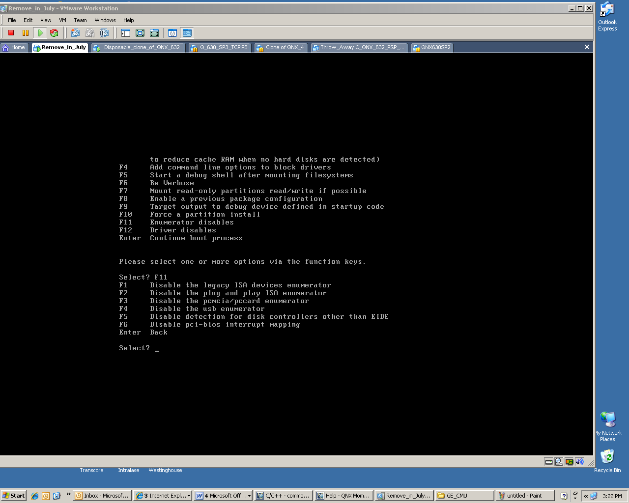

I found my problem is quite similar with this thread:
http://community.qnx.com/sf/discussion/do/listPosts/projects.community/discussion.qnx_momentics_getting_started.topc2500
This guy final solved the problem by chose "disable all but DIDE"
My desktop has only usb keyboard and mouse, no PS/2 holes, and I tried press space in installation as said in that
thread and there was no option of  "disable all but DIDE".
Also, I tried the option "run from CD", it works good and I am able to see the QNX OS.
Do you have any idea of what is the problem?
Thanks very much.
Furui

Re: Installation Error: Unable to access /dev/hd0t77
Hello Furui,
This option (or rater “Disable detection of disk controllers other than EIDE”) is called from “Enumerator Disables”.
I am attaching a snapshot of this situation emulated on my Virtual Machine.
Yuriy
Attachment: Bitmap EIDE_ONLY.bmp 3.75 MB

Hi, Yuriy,
I installed a VM workstation in my computer and the installation of the QNX OS works well in the VM.
I do not know if it works to disable the controllers other than EIDE and install QNX. I will try it when I have time and
 report the result here.
 I really appreciate all your help.
