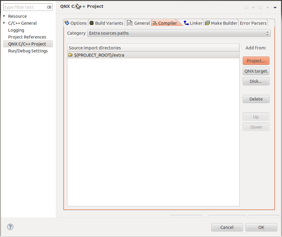

I am just getting started with the QNX momentics IDE. I started creating a simple project but I am running into the
problem where the QNX Momentics IDE cannot seem to link against source files in sub folders of my project.
I have created a very small simple project, it is a QNX C/C++ project. It has the following structure: In the root
folder: MyTest.cc, and a source folder called asdf. In the /asdf/ folder: asdf.h and asdf.cpp exist.

As you can see, this is a very simple example. The project compiles against the header correctly then gives me the
linker error: "undefined reference to doStuff"... I am new to QNX and a rather novice programmer, but this still strikes
me as something the IDE should be able to manage? What am I missing?
I can simply compile this example from command line with
g++ MyTest.cpp asdf/asdf.cpp -o MyTest
and it works just fine, so I am very confused why I cannot get the IDE to do the same.. Any advice?
