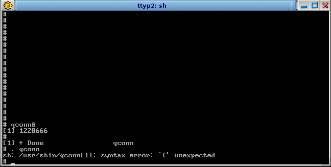

I'm new to Momentics but have used QNX4 for several years.  I'm attempting to set up the development environment on an
Windows XP machine and then connect to a machine runing QNX6 for debugging.
When I attempt to run qconn (qconn&) it immediately exits.  Am I missing something?  I have not even attempted to
connect from the IDE just start qconn.  When attempting to run in in the current session it seems to fail to interpret
the executable.
I've attached a screen shot of the output.
Attachment: Image QNX6_qconn.jpg 36.21 KB
qconn is a C program.
'.' in ksh/sh/bash means eval/source a file containing shell commands.
Instead of:
# . qconn
do
# qconn

 From your image it seems you have qconn running.  (the first call qconn&),
BTW, no need for '&'.
Try pidin after the qconn command to see if it's listed as a running process
(qconn is a daemon).
