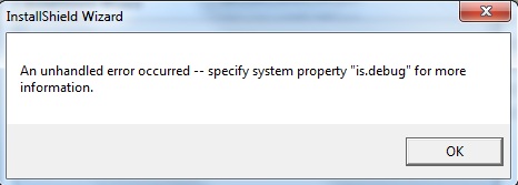

I cannot install Service Pack 1 on SDP 6.5.
I have an installed SDP 6.5. While trying to install SP1 on it, installation progress return me an error which can be
seen on attached file?
My OS is Windows7 Home Premium x64 ENG and I have Java (TM) 7 Update 5 installed on my laptop.
Is there any who can assist me about this?
Thanks in advance.

Re: SDP 6.5 Service Pack 1
As I mentioned in the other thread - SP1 installer should use java from 6.5.0 installation.
To find out why this is not happening in your case, please launch the installer with the debug option and post the
output.
Here is the command to run:
<sp1-installer-executable> -is:log sp1-log.txt
Please post sp1-log.txt

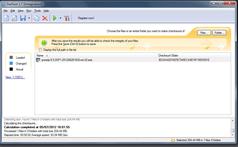

Dear Natalia,
Sorry but, I was able to find an executuable file under
C:\QNX650\host\win32\x86\usr\bin, but I couldn't use it.
According to your comment, I found a program called FastSum which show me the md5 sum but not cksum. Note that md5 sum
result is the same.
See the attached file.
Do you have any suggestion? I can try all, but please tell me how to do, cause I am so junior to Embedded.
Best regards,
Attachment: Image MD5 Sum.jpg 121.86 KB
to verify cksum, you would do something like this:
C:\QNX650\host\win32\x86\usr\bin\cksum <SP1-installer-executable>
How did you install 6.5.0?  Did you use any workarounds?
Do you still have a log file?  The log would usually be in %TEMP% folder or in the same level as your qnx650 install
directory.
