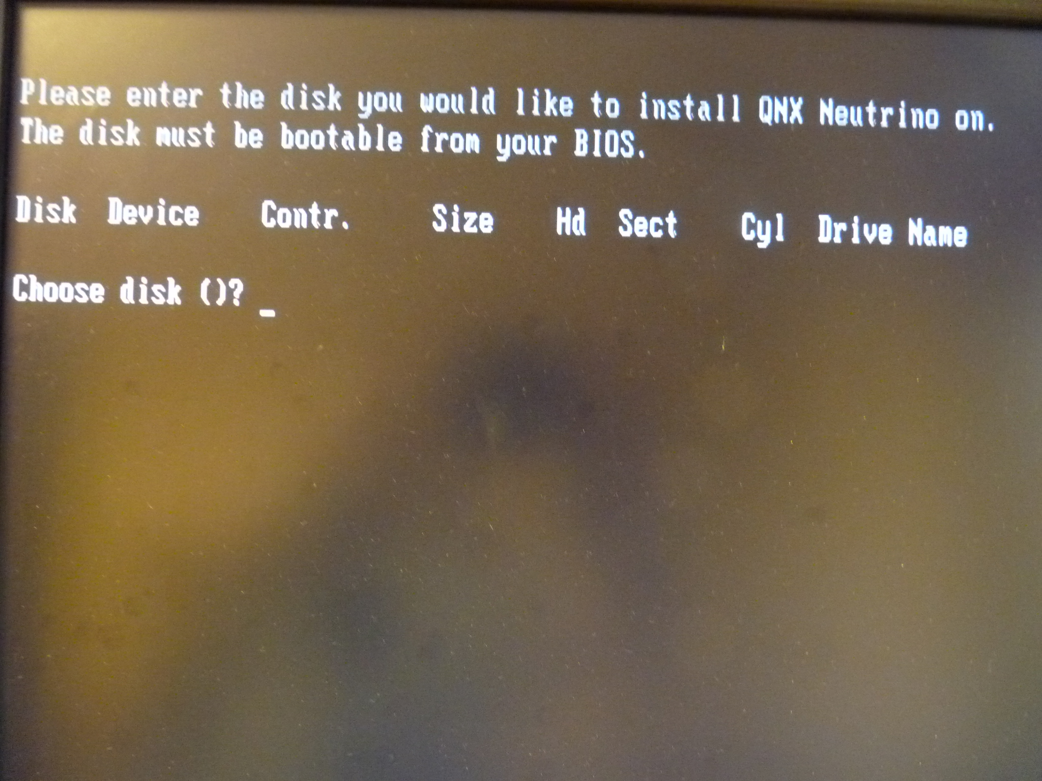

I would like to install QNX 6.5.0 SDP to an PC104 equipment from LIPPERT manufacturer and i can't because the driver of
the sata disk is not recognised by QNX 6.5.0 :
see screen 1/2 (attached)
1/ Is there any solution ?
2/ I can boot on the PC104 with an usb key and format the 2 Serial Ata disks SataDom (screen3) but from there i don't
know how to install qnx. I did not find any procedure on the QNX site.
Any help would be much apreciated.
Many thanks

Change bios mode/remote control to IDE mode.
