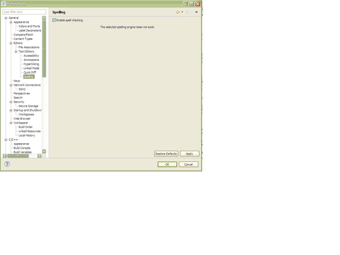

There are no options on the spelling preferences page other than 'enable spell checking'. (see attachment).
The spell checking works in the editor, so presumably it is finding some sort of system dictionary, but I cannot add
words.
Attachment: Image spelling-momentics.jpg 56.33 KB
Re: Spelling dictionary in Momentics needed
from other forum postings
"The CDT version of Ganymede apparently shipped improperly configured. After
playing around for a while, I have come up with the following steps that fix
the problem.
   1. Export your Eclipse preferences (File > Export > General > Preferences).
   2. Open the exported file in a text editor.
   3.
      Find the line that says
/instance/org.eclipse.ui.editors/spellingEngine=org.eclipse.jdt.internal.ui.text.spelling.DefaultSpellingEngine
   4.
      Change it to
/instance/org.eclipse.ui.editors/spellingEngine=org.eclipse.cdt.internal.ui.text.spelling.CSpellingEngine
   5.
      Save the preferences file.
   6. Import the preferences back into Eclipse (File > Import > General >
Preferences).
You should now be able to access the Spelling configuration page as seen
above."
Thank you, adding that line to the preferences worked.
Though I didn't have the line to replace (step 5), adding the correction brought up the spelling preferences.
