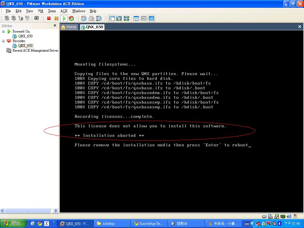

When I install qnzsdp_6.5.0. the application show " This license does
not allow you to install this software " and then install finish.
I use VMware to active a visual disk to run QNX 6.5.0 . Can you help
me to versify this  status. Thank you.
My environment
Windows XP SP3
VMware R Workstation ACE Edition
Qnxsdp-6.5.0-201007091524-dvd.iso and
Qnxsdp-6.5.0-x86-201007091524-nto.iso
Attachment: Image license.JPG 97.83 KB

Hi Abel,
The first thing is to verify your CD image. You should check that the MD5
sum or cksum of the .iso file matches the value in the download center. If
the CD image is corrupt you may see that message. It is misleading.
Keith Russell
