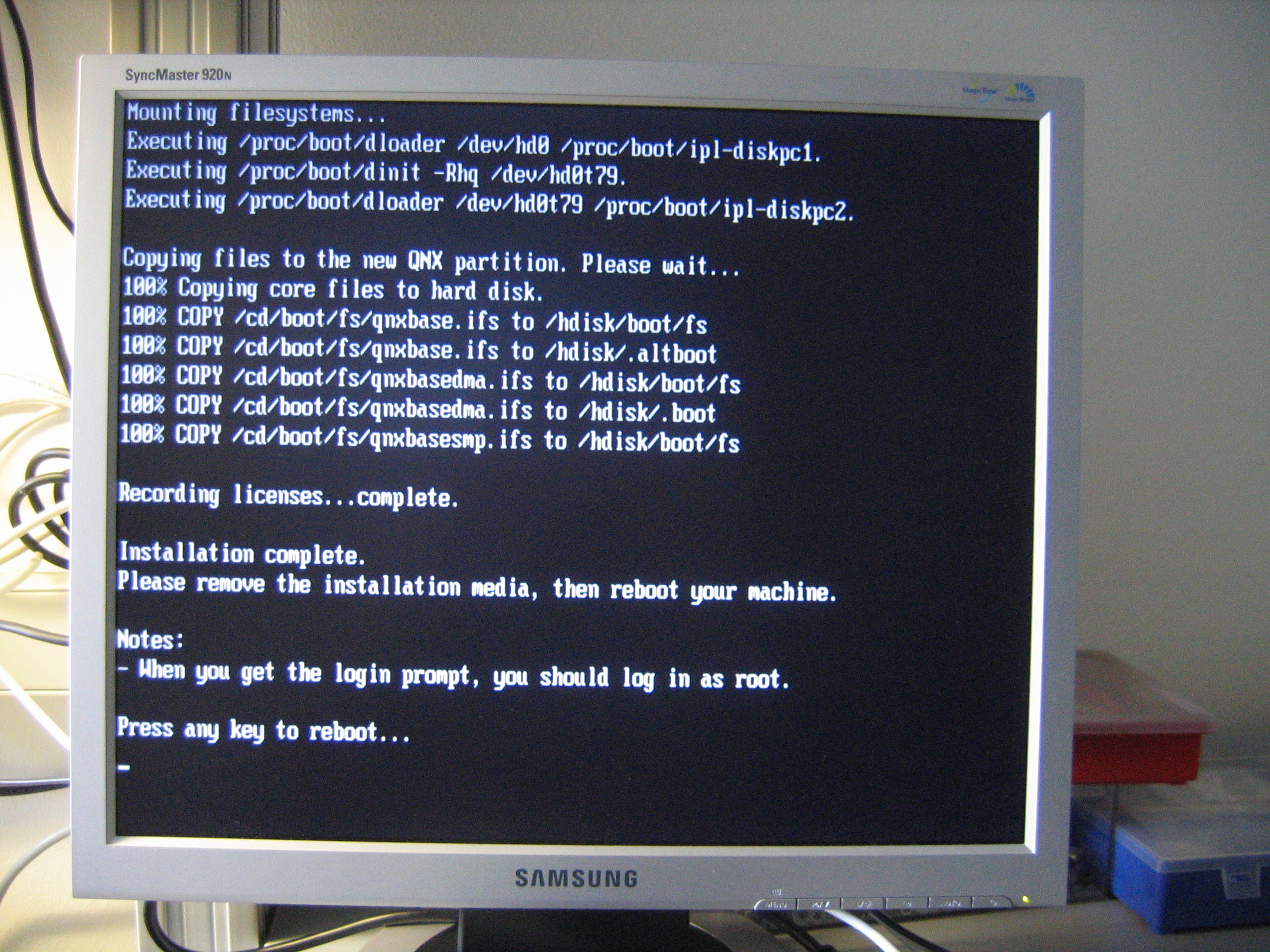

I'm trying to set up QNX Momentics lite on an separate machine. When I install under QEMU on my local machine, it prompt
Recording licenses...complete.
QNX Momentics Development Suite 6.3.2 Development Seat Installation
Throughout the ....
And I can chose location for /usr/qnx632
When I install on the separate machine the installer doesn't ask for anything. When the recording licenses... complete
have been done, it's just say to reboot. And Momentics or qcc isen't installed.
Any ides what can cause this?
Thanks in advantage.

Hey Rodney
Thanks for the reply
I managed to form a solution. I removed the harddrive from the embedded system and installed it in a laptop. I installed
 QNX with success that way around.
I think the reason can be the external USB CD-ROM, I have for the embedded system.
Regarding the amount of disk space theres 120 GB ;)
If you wishes to debug the problem more, I can tell the motherboard is a epic NANO-8522G, and the USB CD-ROM is a
Plextor PX-750UF
Attachment: Image img_3138.jpg 1.72 MB
