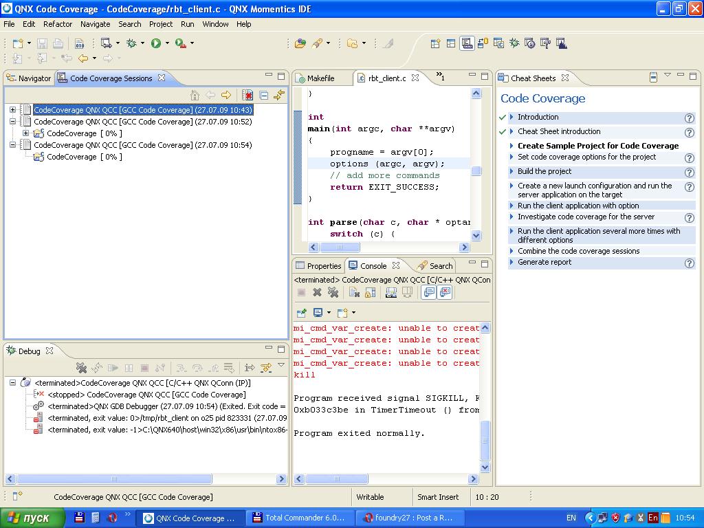

Hello Andy. Thank you for reply.
I create Qnx C++ Project and choose "Build with code coverage", but problem still not resolved. I attach the screenshot
of the problem.
Attachment: Image Problem.JPG 144.7 KB

Re: Code Coverage
Your log file does not have any information about your code coverage
session, is it the full log file?
In your debug session console view, I see several "mi_cmd_var_create"
errors and your program received SIGKILL. This is worrysome. Can you try
to create a simple QNX C project without Code Coverage and try to launch
it in your target? If it works, try to re-compile it with Code Coverage on.
BTW what version of Momentics is running on  your target?
