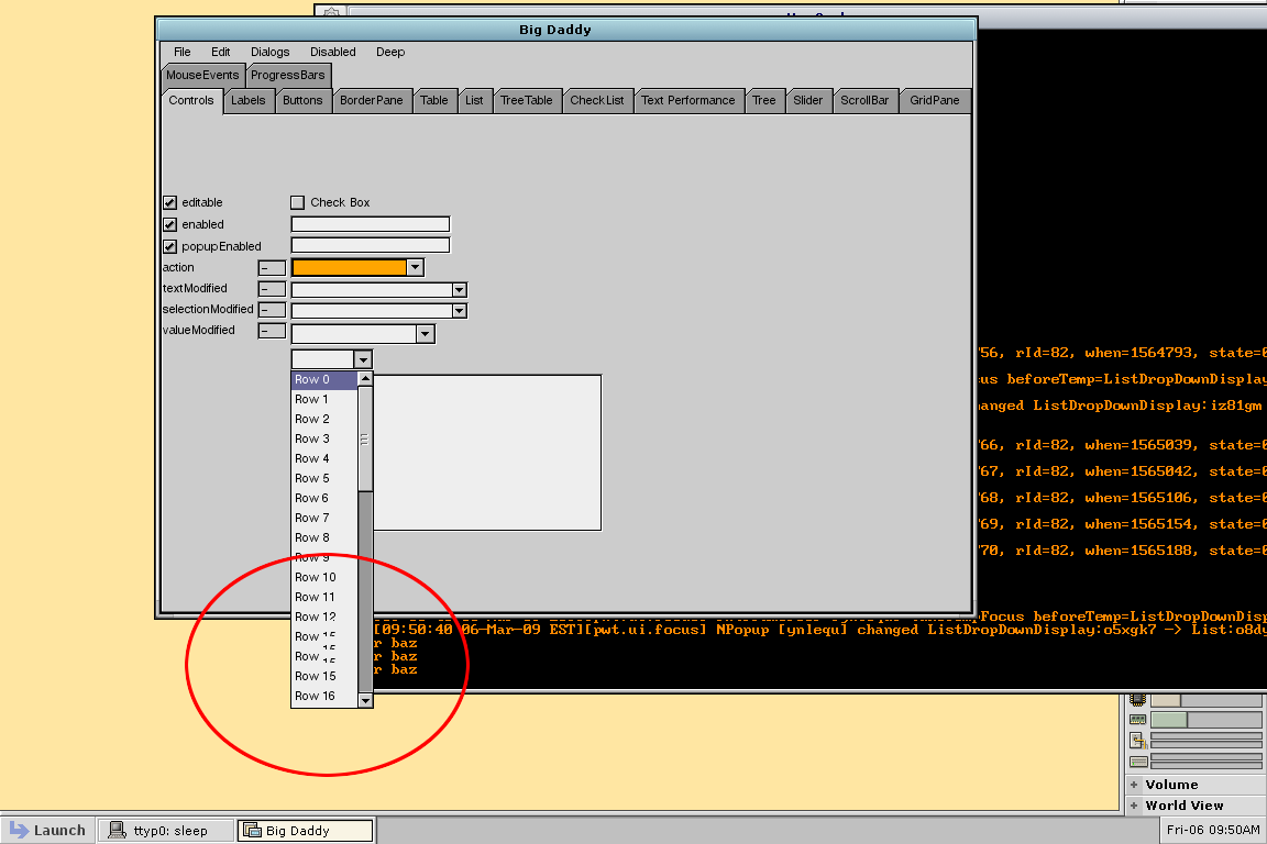

Second, I'm still having some issues here with this approach. Attached is a screenshot of my app showing a dropdown. The
 dropdown is a region owned by ROOT_RID. At the bottom it extends beyond my application window and covers up part of the
 terminal. Even though it is in front of the terminal window, anything that scrolls in the terminal, corrupts the
content of the region. When I mouse over that part of the region it clears up because I do a repaint of the rows
triggered off the mouse move. However I don't know what kind of events will help me when there is no mouse or keyboard
input. Is there something I need to do differently as far as stacking order to help this? I noticed with various photon
apps that have dropdowns (using widgets I assume) they don't exhibit this behavior.
Here is the code I am using for creating the region:

Re: Child Window Focus Question
Your region needs to be opaque to blits: Ph_EV_BLIT.
Thx Misha. I wasn't familiar with that flag. That fixed the issue. One thing I'm curious about. Since regions don't
receive WM events (in particular focus event) how do they know if they should receive mouse and keyboard event? It seems
 that Photon has to have some notion of focus for the regions so that they would get those events.
