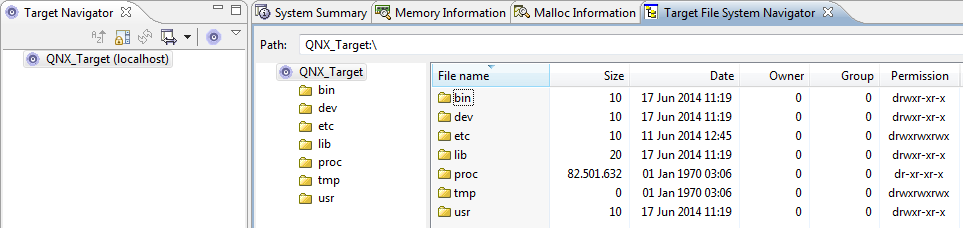

I didn't change any properties so I don't know if I have permission to write into the filesystem, so I add a pic of the
filesystem for further information (there are the permissions as well but I don't know what they mean).

With my beaglebone target i have to create my files either in /tmp/ or on the SD-Card, as my other filesystems are not
writeable.
