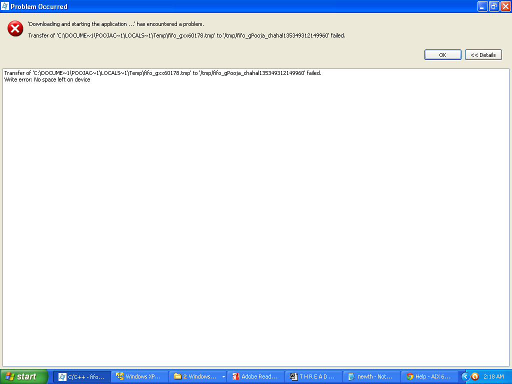

When error like mentioned below come “downloading and starting the application…………..” has encountered a problem.
Transfer of 'C:\DOCUME~1\POOJAC~1\LOCALS~1\Temp\fifo_gxx60180.tmp' to '/tmp/fifo_gPooja_chahal135349373170262' failed.
Write error: No space left on device
this error came when i try to run the program from IDE.
Please suggest me some solution.
Attachment: Bitmap untitled.bmp 2.25 MB
Re: Error in running program
Means no space in /tmp. If you have another folder on device which has
space change it Launch Configuration dialog
