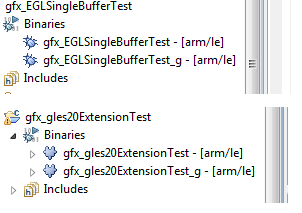

when I compile my QNX c/c++ projects I see two different  icons for the generated binaries,please refer to the attached
image.Could you explain what is the difference between these two icons
Attachment: Image icon.png 8.75 KB
Re: Welcome to the QNX Momentics Community Support Forum !
The two binaries are the same application, except the one with the "_g" contains the symbol tables required for line-by-
line debugging.
