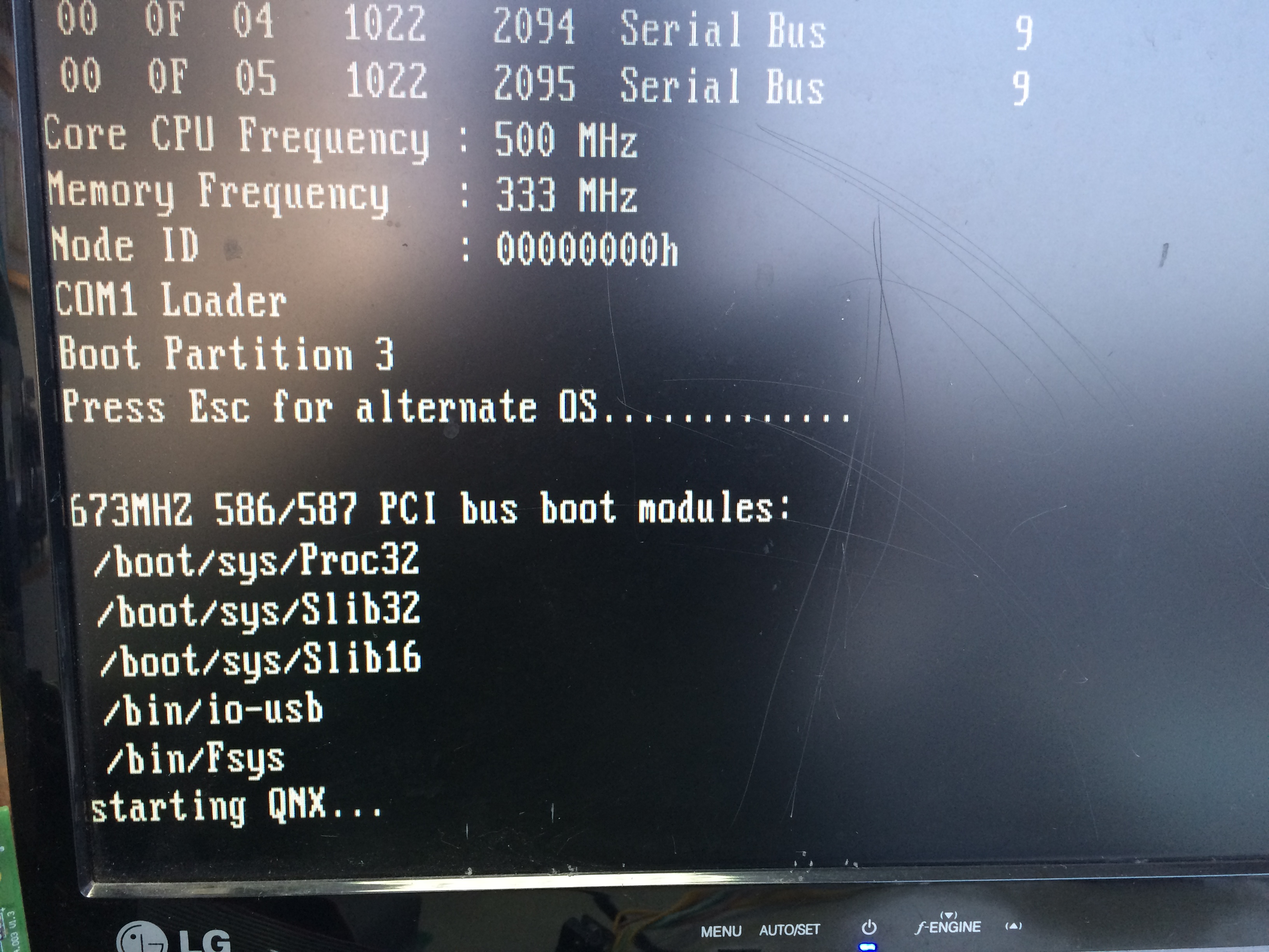

Hi Everybody,
I have to install QNX4 to a usb disk.
1. Format disk:
# fdisk /dev/hd0 >>> make type t77, bootable
# dinit /dev/hd0t77
2. Change .boot file:
I created a boot script that:
/boot/sys/boot
$ /boot/sys/boot -v
/boot/sys/Proc32
$ /boot/sys/Proc32 -l 11
/boot/sys/Slib32
$ /boot/sys/Slib32
/boot/sys/Slib16
$ /boot/sys/Slib16
/bin/io-usb
$ /bin/io-usb &
/bin/Fsys
$ /bin/Fsys
/bin/Fsys.umass
$ /bin/Fsys.umass fsys -n0=hd0
/bin/mount
$ /bin/mount -p /dev/hd0 /dev/hd0t77 /
/bin/sinit
$ /bin/sinit TERM=qnxm
Then I run buildqnx to make .boot file and copy it to root directory.
But it hangs on "Start QNX.."
Attachment: Image IMG_1327[1].JPG 1.63 MB
Re: QNX4 in USB
Hi Cong,
I guess the image may be too large. Try to tune your build file first. Exclude Slib16. It is not needed at boot time,
you can launch it later if required. Also replace io-usb to io-usb-ehci. Can you boot up with that new image?

Hi Mr Oleg,
I replaced io-usb by io-usb-ehci , as you said.
It boot ok, but slowly :)
