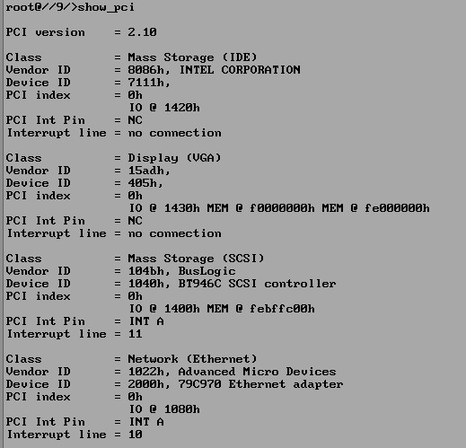

[Oleg] >> Also you can try to launch Hydra.ms to switch to graphics mode and access framebuffer directly using
framebuffer pointer. To get framebuffer pointer you can use show_pci or show_vesa utils.
[Honey] >> We can't understand this fully. We have tried to run show_pci command. Attached file (show_pci.jpg) is the
output which we got. show_vesa command is not found in our QNX 4.25 machine.
Also we are not clear about Hydra.ms; so didn't make a trial on it. How hydra.ms can be used to access frame buffer
directly?
Could you please detail on our concerns?
