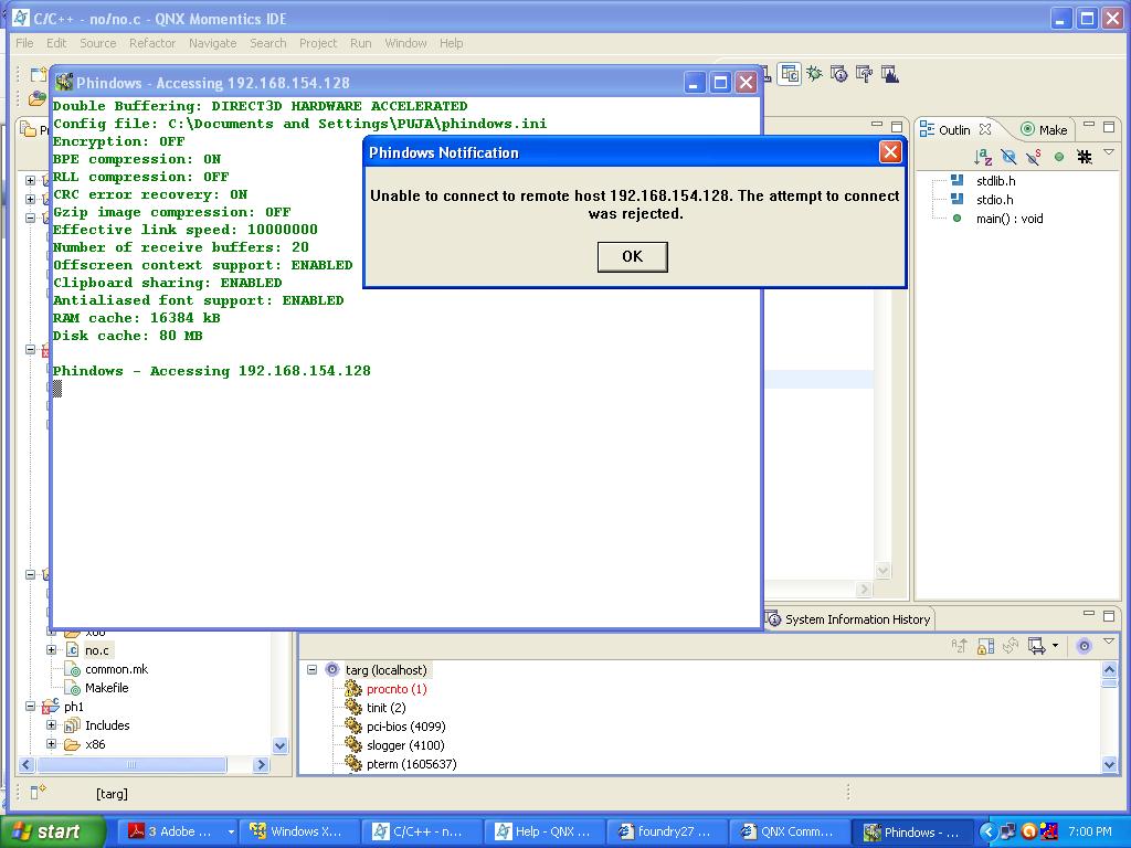

I am currently working with QNX 6.5.0 version,i am using self hosted QNX Neutrino RTOS on VMwareplayer  3.0.0 version.I
am facing problem in launching remote photon.I am trying to connect with phindows from IDE using target navigator.Please
 suggest where i was wrong?
Attachment: Image phindow.JPG 111.41 KB
RE: problem in launching remote photon
Is phrelay configured to run on the (virtual) host with that ip address? You need to enable it in inetd.conf if you want
 phrelay to start automatically. There is a sample phrelay line commented out in inetd.conf.

Re: problem in launching remote photon
please tell me how to make phrelay enable in inetd.conf.
I am using line mentioned below to configure phindows on QNX neutrino host.
phrelay stream tcp nowait root /usr/bin/phrelay phrelay -x
 and " phrelay 4868/tcp" for TCP/IPconnection.
thanks for ur valuable suggestion,nw i am able to connect.thank u.
