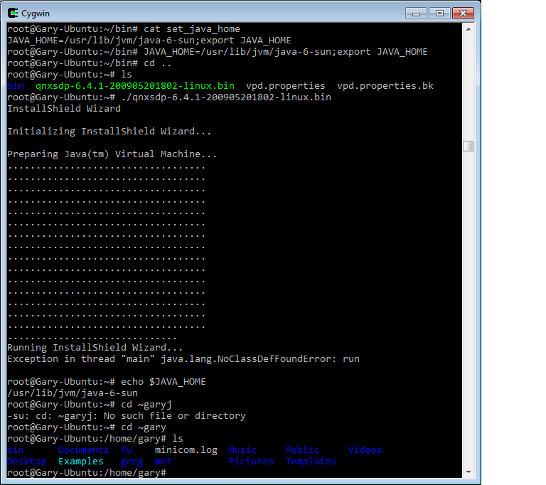

however, when i copied the Linux installer on to Ubuntu, i get an odd Java error. pls see detailed error log below.
Running InstallShield Wizard...
Exception in thread "main" java.lang.NoClassDefFoundError: run

gj-suse91:/home/aaron> ./qnxsdp-6.4.1-200905201802-linux.bin
Initializing InstallShield Wizard...
Preparing Java(tm) Virtual Machine...

What version of Ubuntu and Suse are you using?  Are these 64 or 32 bit systems?
The installer is setup to use Sun JVM 1.5.0 which is bundled in.  It looks like java 1.6 which is in the PATH being
picked up and used by the installer.  That might be the issue.
Try the following workaround to extract java from the installer, and then use it to launch the installer:
mkdir tmp-java
cd tmp-java
../qnxsdp-6.4.1-200905201802-linux.bin -is:extract
./linux-sun-1.5.0.bin
bin/java -cp qnx_linux_setup.jar run
Hope this helps,
Natalia

Re: ERROR : QNX SDP6.4.1 : Exception in thread "main" java.lang.NoClassDefFoundError: run
hello:
i installed QNX641 on openSUSE and it works. so, the only reason it didnt work before is because i has copied only the
SDP bin file and not the setup JAR.
you need both qnx_linux_setup.jar  qnxsdp-6.4.1-200905201802-linux.bin in the same directory when you start the install.
