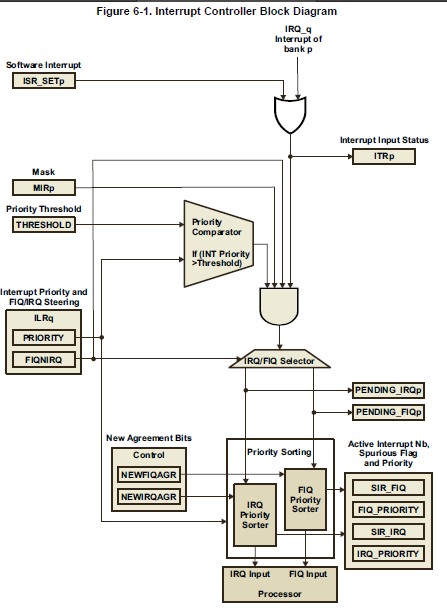

I installed QNX7.0 on my BeagleBone Black. BBB has AM335x SoC which contains PRU-ICSS however, by default, interrupts
from PRUs are disabled - in QNX buildfile system interrupts 20-27 (PRU events) are marked as "Reserved":
## vector:    20 - 27
## trigger:    N/A
## device:    Reserved
I would like to enable it. Does anyone know how to do that?
Additionaly, I am not sure what "Reserved" means. On the begining I thought that "Reserved" means that there is no
handler for these interrupts so sending it would cause system crash. I also thought that maybe there is some very simple
 handler which does nothing but erasing the source of the interrupt. However, when I generate interrupt from PRU, the
main INTC does not even get this interrupt - ITR register is clear  - how is that possible?

Thanks for reply. You are probably right. This means that the PRU INTC is not sending interrupt. To verify this theory I
 tried to send an interrupt from one PRU core to another. It turned out that it is not possible. It is very odd. HIPIR
register  shows that my interrupt has the highest priority and also SECR register shows that my interrupt is enabled.
Assuming that my code is correct, everything should work fine, but it is not. Is it possible that the signals from PRU
INTC are blocked somehow or I am just making some stupid mistake ?
Regards
