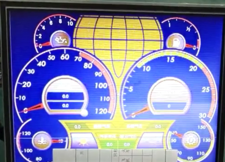

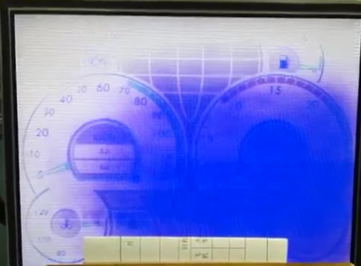

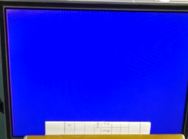

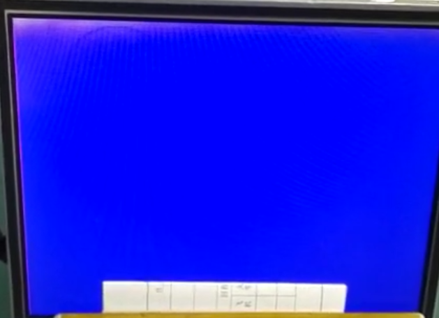

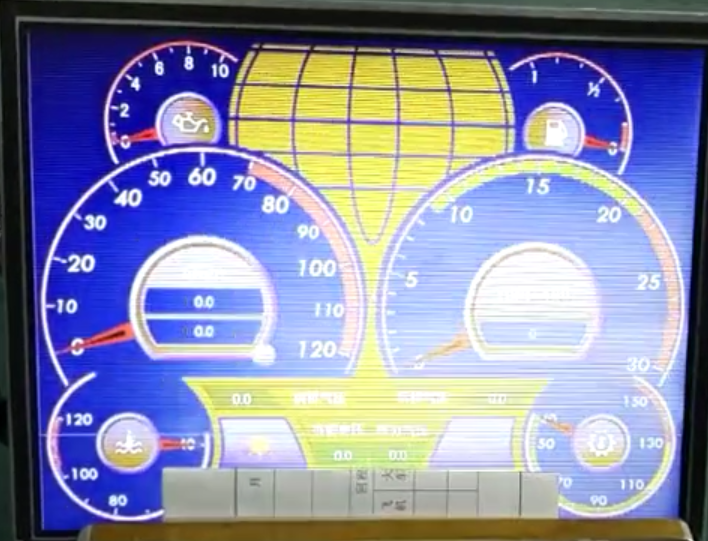

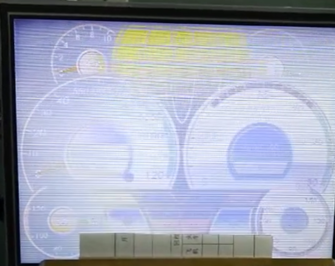

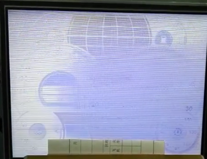

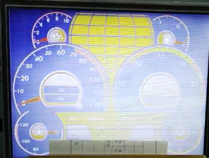

My QT program has several threads,
T1 QT display thread
T2 CAN recv thread
T3 save data thread
QT program is running,but screen display disappeared, Why ?
as shown in the attachment ,

there are many things that can go wrong but as a guess from my part this is a problem with the display access. Maybe
something is wrong with some of the many clock settings.
Is this happening only with a Qt application? Is running "gles2-gears" stable?
How long does it take for the display to become blue?
Are you sure the modlib matches your display and the clock configuration of the BSP?
