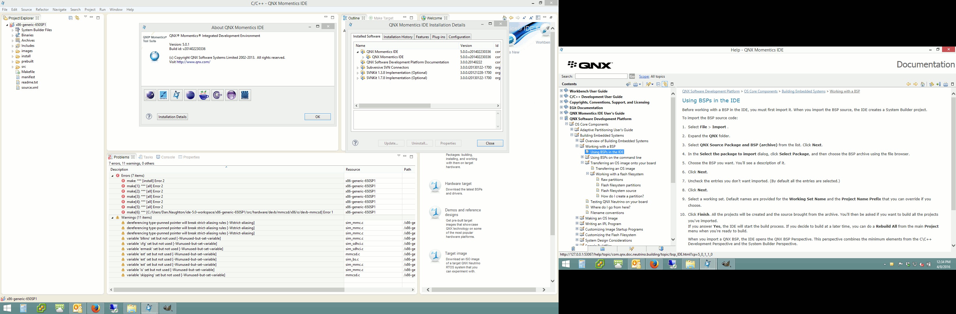

I followed the 10 instructions in the building a BSP for the first time to the letter - and there are all sorts of build
 errors.  If someone has a moment to look at the attached screenshot - maybe tall me if I've missed something.  This is
my first day with QNX, and I fell on my face right out of the gate.
Attachment: Image qnx.png 141.7 KB
Re: Noob just starting - trying to build x86 BSP - followed instructions - build broken - need advise. [SOLVED'[
It looks like the IDE needs to be the match the release of the BSP.  I uninstalled 6.6, installed 6.5.1 and it's working
.  Sorry for wasting anyone's time.
