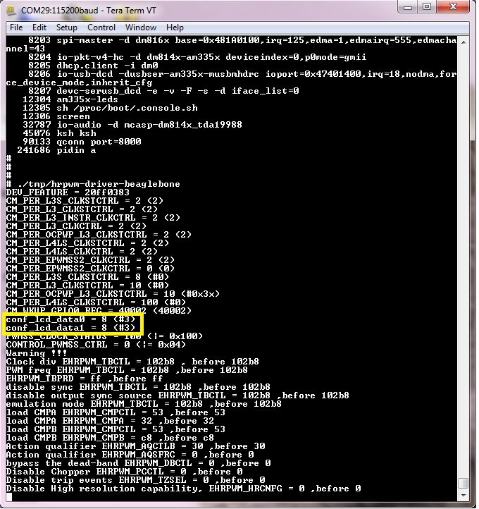

I try to configure pin gpmc_ad8 and gpmc_ad9 of BeagleBone Black(BBB) operating as an eHRPWM (PWMSS2) in QNX RTOS as
shown in these lines of code below:
#define conf_gpmc_ad8 (0x44E10000+0x0820)
#define conf_gpmc_ad9 (0x44E10000+0x0824)
#define CONTROL_CONF_MUXMODE(n)        (n)
uintptr_t GPMC_AD8_REG = mmap_device_io(4, conf_gpmc_ad8);
if(GPMC_AD8_REG == MAP_DEVICE_FAILED)
    perror("Can't map GPMC_AD8_REG");
    return 0;
reg_val = CONTROL_CONF_MUXMODE(4);
out32 (GPMC_AD8_REG, reg_val);
usleep(10000);
stt_done = in32(GPMC_AD8_REG);
printf("CONTROL_CONF_GPMC_AD8 = %x (#4)\n", stt_done);
uintptr_t GPMC_AD9_REG = mmap_device_io(4, conf_gpmc_ad9);
if(GPMC_AD9_REG == MAP_DEVICE_FAILED)
    perror("Can't map GPMC_AD9_REG");
    return 0;
reg_val = CONTROL_CONF_MUXMODE(3);
out32 (GPMC_AD9_REG, reg_val);
usleep(10000);
stt_done = in32(GPMC_AD9_REG);
printf("CONTROL_CONF_GPMC_AD9 = %x (#4)\n", stt_done);

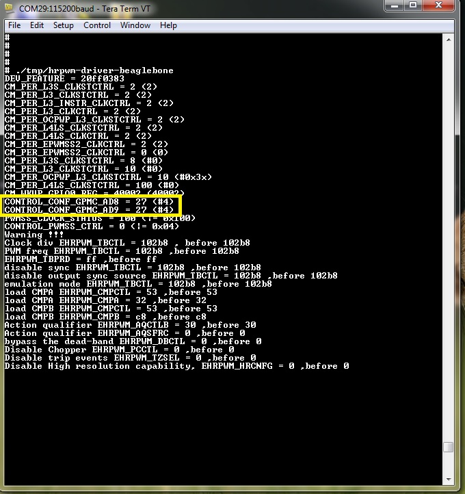

But I can not change the value of these registers as write value (show on picture 1). I dont know why, the reason can be
 my wrong procedure or other problem. Somebody who have been worked with Beagle and QNX can help me.
PS: If I use pin lcd_data0 and lcd_data1, these values are still wrong. While other registers I configured for system
clock or PWMSS2 are right. (show in picture 2)
Attachment: Image problem2.jpg 193.46 KB Image problem.jpg 164.27 KB
Re: Write to register (memory) problem with BeagleBone Black when using QNX RTOS
Anyone can help me or just execute this code to test, and post some pictures here if you get the same problem. Thanks
