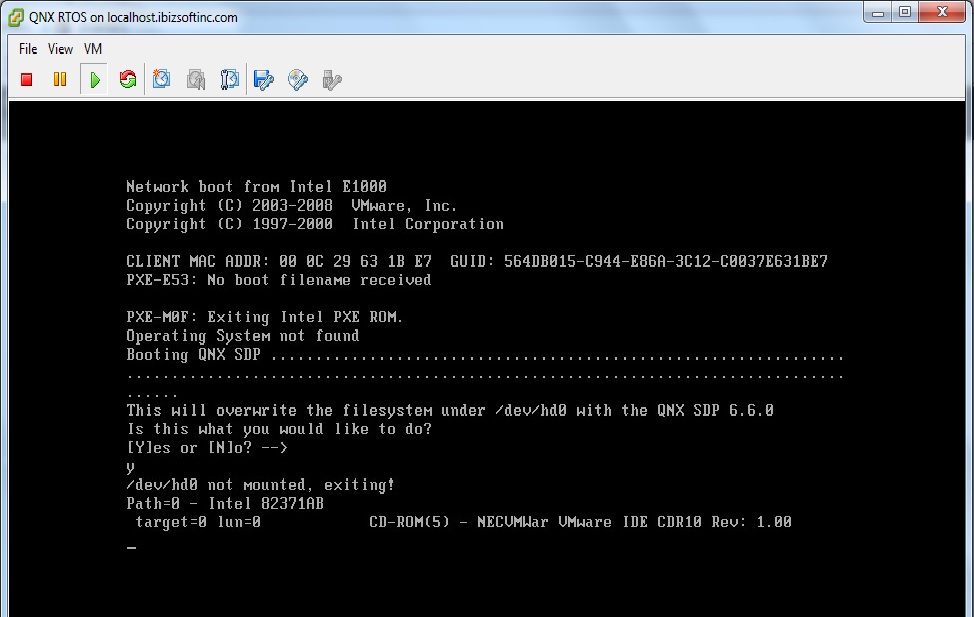

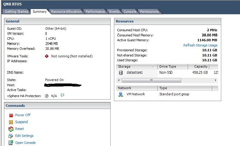

QNX neutrino RTOS 6.6 installation issue on VMWare
    I have installed QNX SDP6.6 and SDK for Apps and Media1.0 on windows 7. I have downloaded the VMWare image of QNX
neutrino runtime system and tried to install it on VMWare. Currently I am getting some error while installing QNX
neutrino RTOS on VMWare. Here I am attaching the screenshots of the error and the VMWare details FYI.
Any solution for this will greatly appreciated.
Thanks in advance.
Attachment: Image vm.jpg 86.64 KB

Attachment: Image bootscrn2.jpg 110.89 KB
Re: QNX neutrino RTOS 6.6 installation issue on VMWare
Which VMware product are you using?
Should have
Operating System: Other
Version: Other
Hard disk should be EIDE
Hard disk should be created with size at least 2G
256 MB memory is fine
Networking NAT generally works well.
I see that your VM tried to do a network boot first, it should be set to boot from CD ISO image first time and then Hard
 Disk once the OS have been installed.
