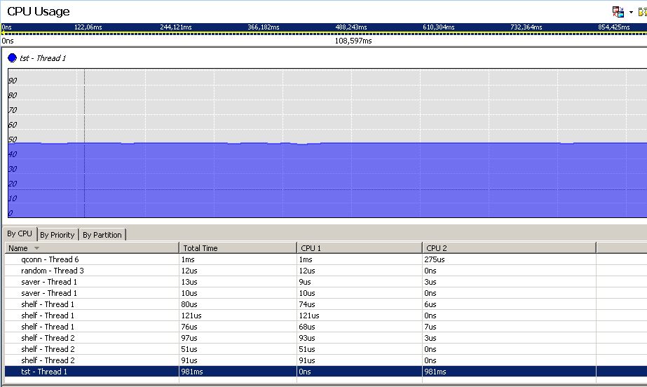

You can use Your IDE45 and get a kernel trace in wide mode.
then You can get infos like in attached picture.
