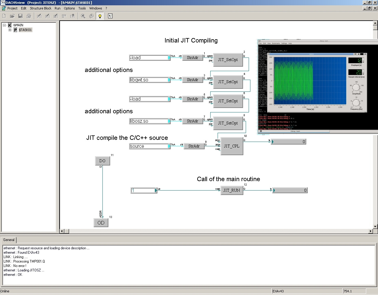

that's the way it works:
// command number 1
#/home/opt/qwt-6.0/examples/oscilloscope/obj # gcc -shared -o libosz.so curvedata.o moc_knob.o moc_plot.o moc_wheelbox.o
samplingtread.o wheelbox.o knob.o mainwindow.o moc_mainwindow.o moc_samplingthread.o plot.o signaldata.o
// command number 2
#/home/opt/qwt-6.0/examples/oscilloscope # clang++ -I/usr/share/qt4/mkspecs/default -I. -I/usr/include/QtCore -I/usr/
include/QtGui -I/usr/include/QtSv -I/usr/include -I../../src -Imoc -O3 -emit-llvm main.cpp -c -o source.bc
// copy libosz.so and source.bc to the directory of dV ...
// start the DACHSview++ target ...
#/home/opt/qwt-6.0/examples/oscilloscope # dV &
A picture of the small DACHSview++ program and the result is in the attachment.
DACHSview++ is our new advanced Soft PLC and a general purpose development tool for real-time application
