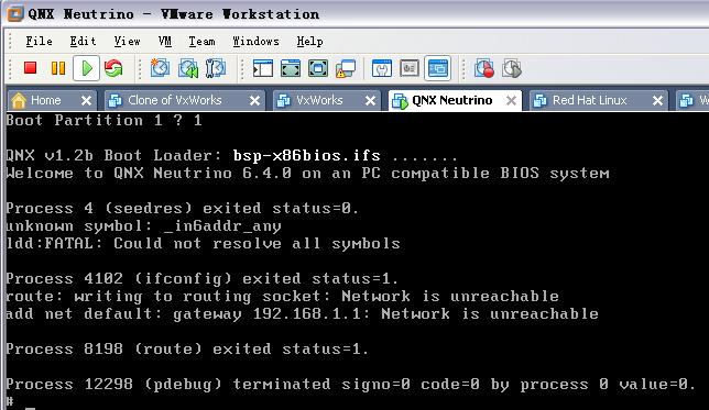

Hello,everyone:
I am a newble to QNX,when I build the embedded system,I cannot get the network util "ifconfig " to work,can anybody help
,thx
here is my build file and bootsh:
# Programs require the runtime linker (ldqnx.so) to be at a fixed location
procmgr_symlink ../../proc/boot/libc.so.3 /usr/lib/ldqnx.so.2
# Start up some consoles
devc-con -n4 &
reopen /dev/con1
display_msg Welcome to QNX Neutrino 6.4.0 on an PC compatible BIOS system
slogger &
# Start the pci server
seedres
pci-bios &
waitfor /dev/pci
#start NIC driver with full TCP/IP stack
#with half duplex operation in this case
io-pkt-v6-hc -p tcpip
#io-pkt-v6-hc -d pcnet duplex=0 -p tcpip
#wait until io-net starts
waitfor /dev/socket
ifconfig en0 192.168.1.100 netmask 255.255.255.0
route add default 192.168.1.1
# Some common servers
pipe &
mqueue &
devc-ser8250 -e &
devc-pty &
# Start a debug server for debugging programs
waitfor /dev/ser1
[+session] pdebug /dev/ser1 &
# These env variables inherited by all the programs which follow
SYSNAME=nto
TERM=qansi
# Start some extra shells on other consoles
reopen /dev/con2
[+session] sh &
reopen /dev/con3
[+session] sh &
# Start a high priority shell just in case....
reopen /dev/con4
[pri=25 +session] sh &
# Start the main shell
reopen /dev/con1
[+session] sh
# [+session] login -p
