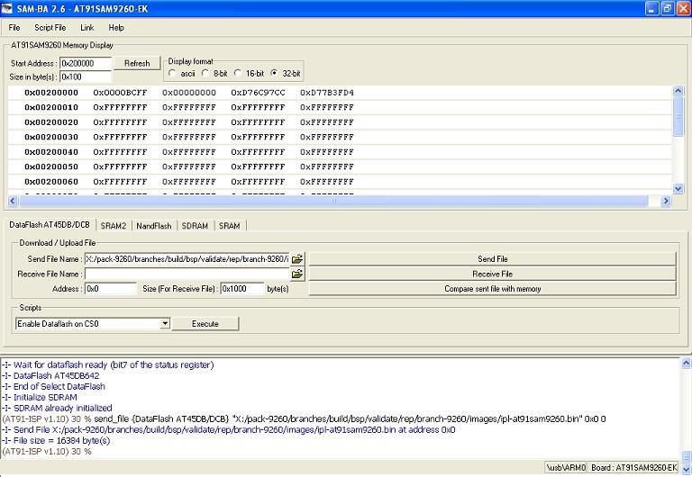

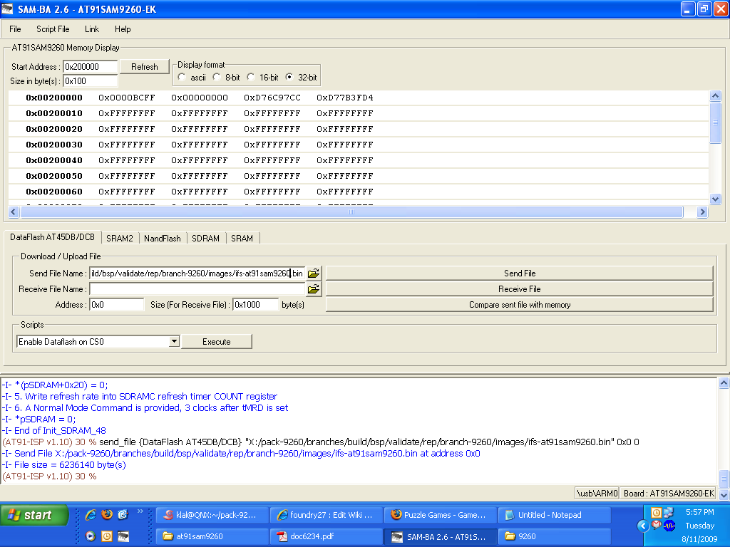

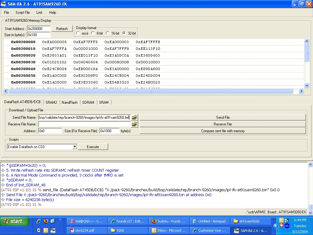

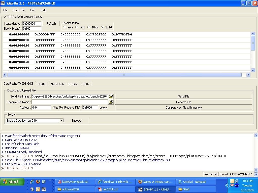

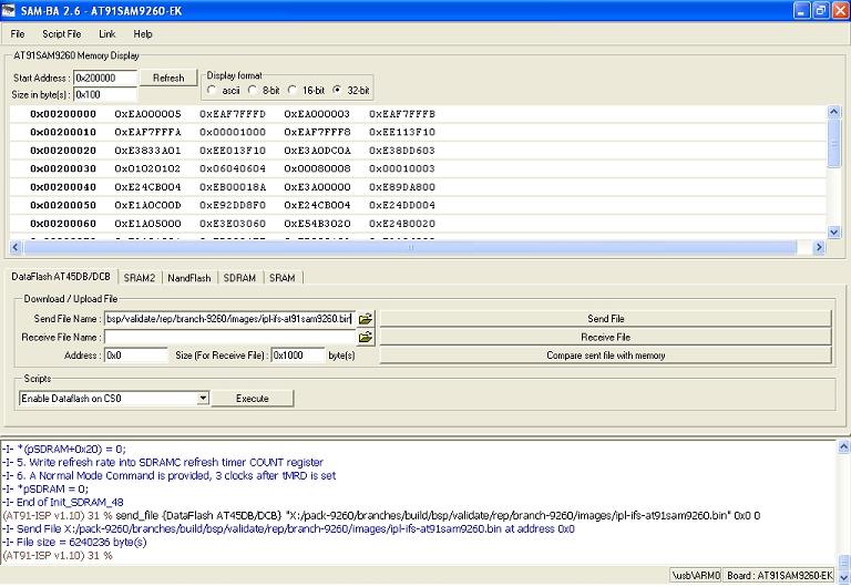

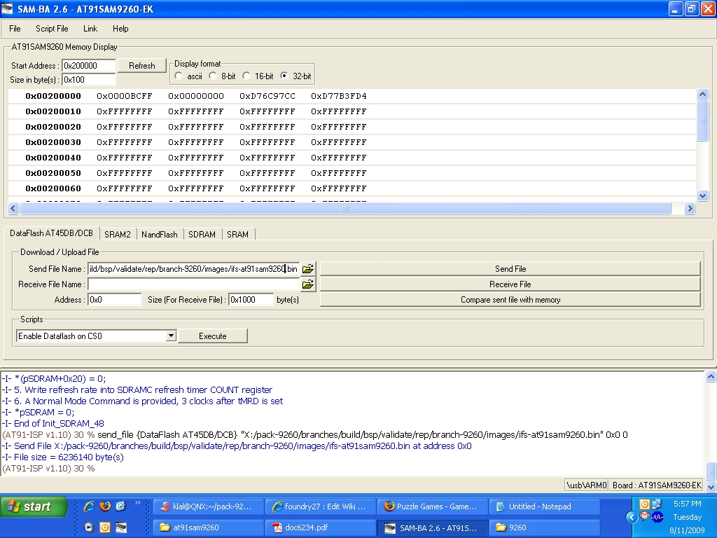

Step 3: Download the Bootable IFS image.#The Boot Program integrates different programs that manage download and/or upload into the different memories of the product. First, it initializes the Debug Unit serial port (DBGU) and the USB High Speed Device Port.
Install and setup SAM-BA#1. Install "AT91-ISP v1.12.exe" . 2. Intall "ActiveTcl8.5.5.0.287690-win32-ix86-threaded.exe" i.e.TCL environment which is used by SAM-BA (any other TCL environment can also be used) . 3. Connect serial cable with windows machine, and use any serial port application such as teraterm or hyperterminal, and attach it with COM device, with baud rate set as 115200. Make sure the on-board data flash and NAND flash contain no bootable images. 4. Restart the board, hyperterminal will be showing following message . RomBOOT > 5. Connect usb cable with windows machine, It will prompt with a new usb hardware found message, and will try to install the corresponding driver. 6. Check device has enumerated properly by looking into device manager . 7. Start SAM-BA 2.6 with \usb\ARM0 as connection. Loading the IFS image using SAM-BA#
