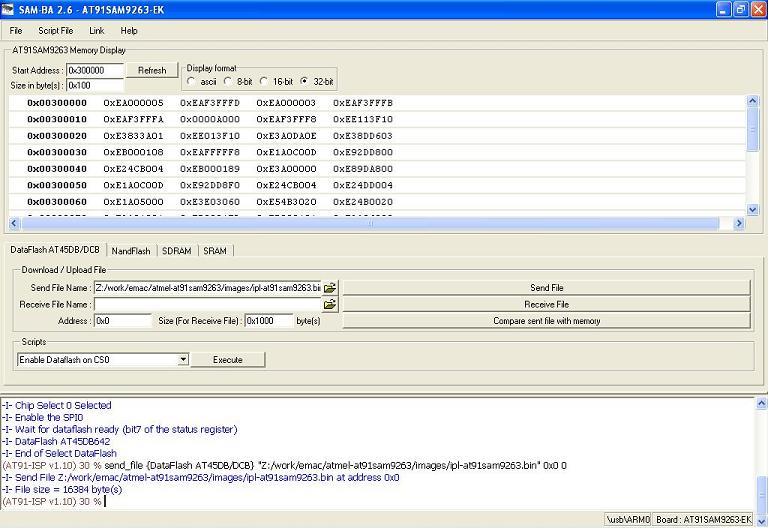

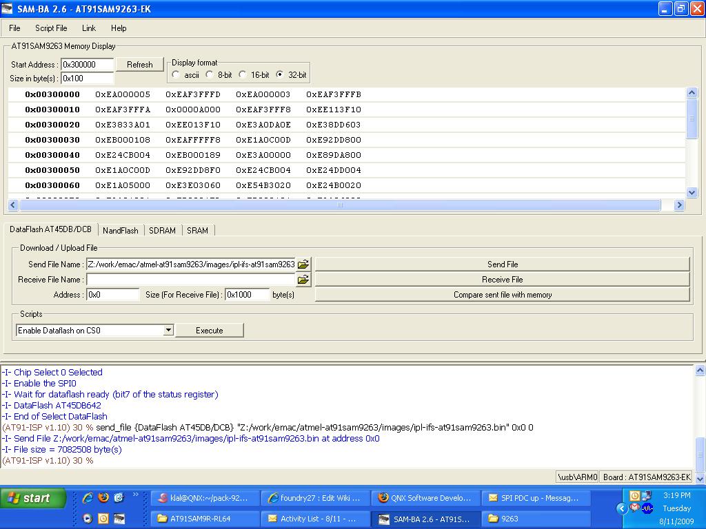

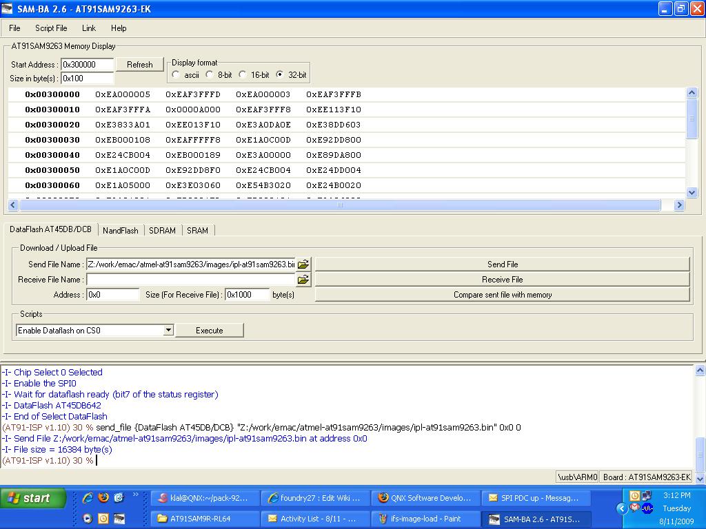

Step 3A: Download the Bootable IFS image.#The Boot Program integrates different programs that manage download and/or upload into the different memories of the product. First, it initializes the Debug Unit serial port (DBGU) and the USB High Speed Device Port.
Install and setup SAM-BA#1. Install "AT91-ISP v1.12.exe" . 2. Intall "ActiveTcl8.5.5.0.287690-win32-ix86-threaded.exe" i.e.TCL environment which is used by SAM-BA (any other TCL environment can also be used) . 3. Connect serial cable with windows machine, and use any serial port application such as teraterm or hyperterminal, and attach it with COM device, with baud rate set as 115200. Make sure the Atmel Data-Flash card is not pluged in the socket A. 4. Restart the board, hyperterminal will be showing following message . RomBOOT > 5. Connect usb cable with windows machine, It will prompt with a new usb hardware found message, and will try to install the corresponding driver. 6. Check device has enumerated properly by looking into device manager . 7. Start SAM-BA 2.6 with \usb\ARM0 as connection. Loading the IFS image using SAM-BA#
Press the reset button, now on your terminal you will see output as follows:
RomBOOT
QNX Neutrino Initial Program Loader for ATMEL AT91SAM9263-EK
Commands:
Press 'D' to download an OS image from serial port, using sendnto utility
Press 'F' to Boot an OS image from SPI/SERIAL flash
ATMEL AT45DB642D/AT45DCB008D SPI Flash detected.
QNX IFS image detected on page: 00000010 Offset: 00000220 Size: 0057E240
######################################################Done
found image, calling image setup...
image_setup OK, calling image start...

Step 3B: Reprogram the IPL.#In case if Board is new or IPL gets corrupted, We can reprogram IPL using SAM-BA application.
