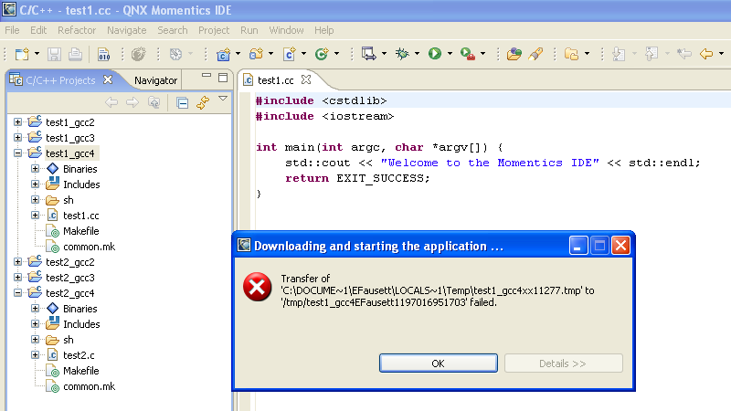

I have no problem running the gcc2 and gcc3 projects from the Run->C/C++ QNX QConn option in the IDE, however I get the
following error when doing the same for the gcc4 projects:
Dowloading and starting the application ...
"Transfer of 'C:\DOCUME~1\EFAUSETT\LOCALS~1\Temp\test1_gcc4xx11273.tmp' to '/tmp/test1_gcc4EFausett1197016749359' failed
This error pops-up in a dialog window with no additional information.
I'm attaching a screenshot.
