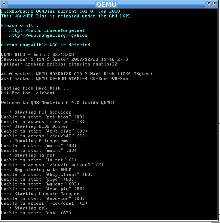

Hi everyone,
I'm trying to run QNX (source code) on QEMU but either the compilation,
or the image creation went wrong. I expect to end-up with a running
console/shell.

The screen shot (qemu) is attached to this mail (basically says "unable
to start ..." and "unable to access dev/...").
