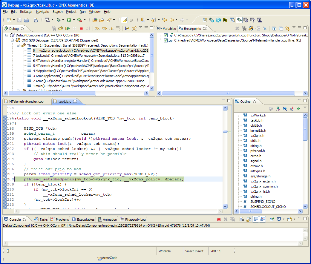

Ok, so I hacked a set of VxWorks headers together and got the application library I want compiled. I have linked the
library and the vx2qnx library into an executable which I am now running on a QNX machine.
The problem is that I am getting seg faults on weird function calls. I'm attaching a screen shot. Any ideas? This one
is on a simple semaphore call.

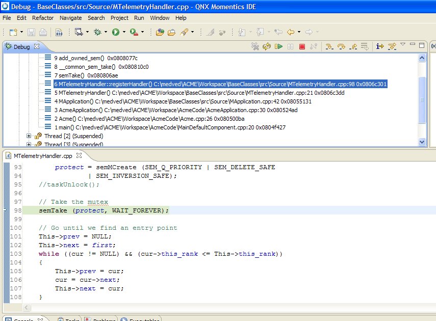

The first call to taskLock() is what gives the seg fault. I compiled
the vx2qnx lib with the source that came in the archive with debug
symbols, where the error is occurring in the library is shown in the
following screen cap.
As you can see in the call stack, I'm a couple of calls deep in the init
stuff of my application.
This help?

What is causing the seg fault is that my_tcb is null. So, obviously when
it derefs it, we are going to have problems. The function taskLock()
which calls the __vx... func looks like this:
STATUS taskLock(void) {
WIND_TCB *tcb = GET_OUR_WIND_TCB();
__vx2qnx_schedlockout(tcb, 0);
return OK;
And GET_OUR_WIND_TCB is :
#define GET_OUR_WIND_TCB() \
(WIND_TCB *)pthread_getspecific(__vx2qnx_tcb_key)
In vx2qnx_common.h. so the tcb pointer is null... thoughts?
compiled
debug
the
the init
This help?
M

So, yeah, what I had to do was call usrInit from my QNX main task, then
use spawnTask to spin off a VxWorks task and get that stuff rolling.
Appears to have fixed the problem...
M
