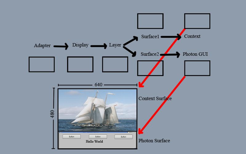

Last night Coming an Idea , I have taken a glance advanced graphic from beginning in help file, I think some such as in
the picture.
Can it be True? can I do that?
When it can be How can I attach photon 2 surface2?
Attachment: Image adapter.jpg 144.44 KB

if you want to only use one layer, I think you would need to make a
hybrid GF/Photon application for the 'sailing ship picture'.  You can
still make all the normal GF calls, they just get marshaled through the
Photon engine for the blit to the screen.
Go here:
http://community.qnx.com/sf/frs/do/viewRelease/projects.graphics/frs.pho
ton.gf_ph_2d
and look at gf-ph-2d.tgz
