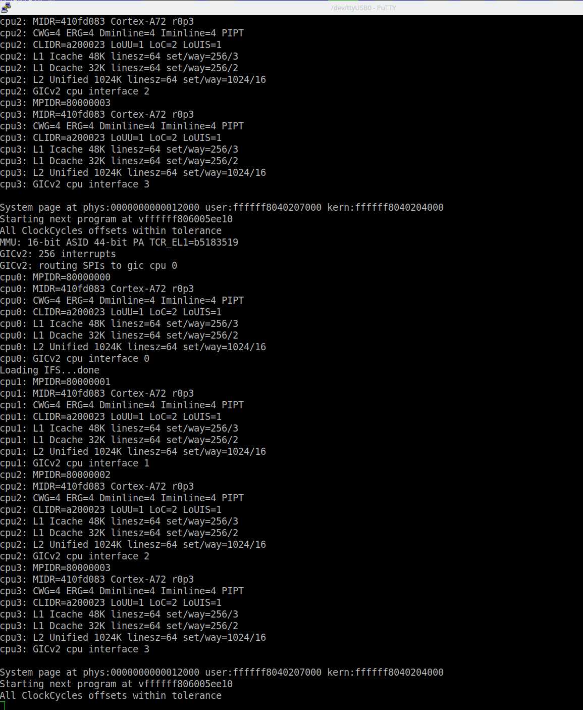

I brought a suitable USB/serial cable into work today and using the firmware files Roger pointed me to was able to see
the RPi trying to get started. I have attached a screenshot of the terminal output.
From startup where the first line is "MMU: 16-bit ASID..." it gets to the final line where it says"All ClockCycles
offsets within tolerance", pauses for a couple of seconds, and then repeats from the MMU: line. Just keeps going around
and around.
I don't think it's getting to where it wants to load the IFS file. I looked into the BSP for "All ClockCycles" and
couldn't find anything like that.
I am not sure if I'm using the very latest BSP (as the one I'm using has up until now been very stable) so when I can
I'll check that out and see what happens. But as I said, I don't think it's getting to load the IPL.
Geoff.
Attachment: Image rpi4_terminal.png 304.62 KB

(and then try the SD).  This works well so with the formatted USB stick I put the EFI partition followed by my qnx6
partitions and works like a charm - no need for the SD card.
Also intrigued by the network boot possibilities :-)
Re: Post pandemic Raspberry Pi4's don't seem to work.
Hi David,
I might be interested in how you do this but right now I am grappling with usblauncher_otg on the RPi4 and I'm hoping
you can help as you indicated earlier on that you had this working. I will create a new thread for this however.
Geoff.
> One update is that I used the Raspberry Pi Imager to burn a new boot loader
> for the Pi4 that allows it to boot from USB (and then try the SD).  This works
> qnx6 partitions and works like a charm - no need for the SD card.
In regards to our inability to write to the SD card using post-pandemic RPi4's, my colleague here has managed to resolve
 it. We can now write to any partition type (in our case 12 and 177).  The following works for us with only a slight
loss of read/write performance.
devb-sdmmc-bcm2711 mem name=below1G sdio addr=0xfe340000,irq=158 disk name=sd blk mntperms=755
Basically, he removed everything to do with the bus master.
Geoff.
We have managed to figure out how to write to the SD card in teh post-pandemic RPi4's by starting the SDMMC driver as
follows:
We notice a small loss of read/write performance but it's acceptable. It works for us!
Geoff.
