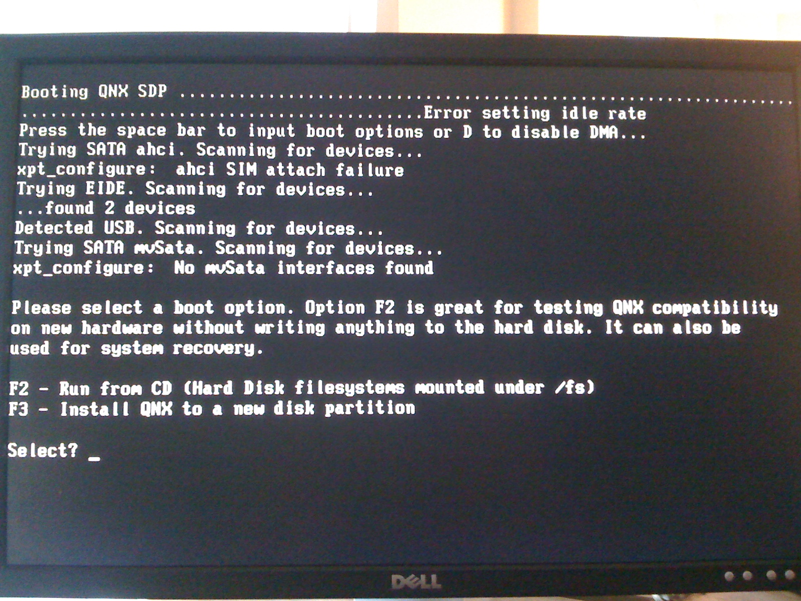

I am trying to install QNX on my system and get the following error:
Error setting idle rate
I took a snapshot of the message on my monitor and it is attached.
Out motherboard is Asus Rampage 3 Extreme. If any additional info is needed, please let me know.
Many thanks in advance.

Are you using the latest BIOS?

Yes, I am using the latest BIOS for the motherboard. The motherboard itself has many USB ports but only 1 PS2/2 port
(and it says it is for the keyboard).
I have tried almost every imaginable combination with the keyboard and the mouse, but to no avail.
Any help is appreciated.

Using the latest one for sure.
I definitely understand what you mean about being on the very latest hardware, and that is noted.
1) Cannot boot. Error message:
Unable to start HID server
4102 terminate with signal 11
4101 exited with status 0
4100 exited with status 0
4099 exited with status 0
It exits to the console, at which point the keyboard is not functional.
2) Cannot boot. Same message as above.
Cannot proceed onto steps 3 and 4.
Let me know if you need any more info.
