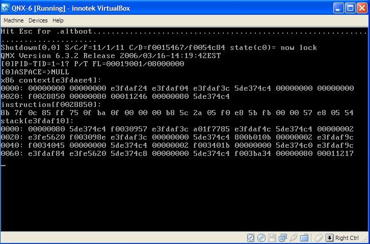

I would like to run QNX under the Virtual Box virtual machine - http://www.virtualbox.org/.  Unfortunately, I get a core
 dump when QNX install starts.  A copy of the screen dump is attached.
Any help is much appreciated.
Ross
Attachment: Image QNX-Dump.jpg 74.65 KB

I get the same core dump on OS X running virtual box
Re: Running Momentics using the VirtualBox Virtual Machine
It's a bug in VirtualBox - they don't support the use of Ring 1 by guests.  I spoke to them and they will look at a
workaround eventually (obviously it's not a high priority for them).  For now, you can use VT-x mode which works
properly.
Colin
6.4.0 installed just fine for me in VirtualBox 2.0.6 on an Ubuntu 8.04 machine.  I did have to enable VT-x of course.
It's not enabled by default - can you double check?
BTW, I talked to the VirtualBox people and they can't fix the non VT-x case right now, but will put in a QNX
configuration that dis-allows non VT-x, in a way similar to OS/2
Colin
Thanks.
I checked the BIOS settings.  Virtualization was disabled.  I enabled it and was able to install QNX successfully.
However, when I boot QNX, the mouse is uncontrollable.
When QNX boots, I get the message - Can't locate the PNP bios.   I suspect that's behind the mouse problem.
Any thought you mught have are much appreciated.

RE: Running Momentics using the VirtualBox Virtual Machine
Hi Shital,
VirtualBox doesn't support operating systems that utilize Ring1 in non VT-x mode.
So unless your hardware supports VT-x and you have it enabled, you cannot run
QNX in a VirtualBox VM.
Colin

Dont know if it will work for all, but I got QNX 6.32 up and running on VirtualBox  on my Intel Core 2 Duo Win XP Laptop
See http://kverma.posterous.com/getting-qnx-632-to-work-on-virtualbox for more details.

I'm trying to install QNX Neutrino 6.3.2 using VirtualBox 3.1.4 (for Windows hosts) on Windows Vista Home Premium OS
host. The Processor is AMD QL-65 (supports virtualization). VT-x is enabled. However, when I try booting it from the iso
 on the CD, it gets stuck after "Press Esc for .altboot................................................". The log file's
 last line is "Booting from CD-ROM" and is stuck at that. Has anyone had similar problems and managed to get a work
around it?
I've gone through the above posts with no luck.
It works fine with VMware though.
Thanks.
I found out that the same problem occurs on non-free Virtualbox editions running under x86 Linux - I think it's a bug.
Everything works fine on a x86_64 host even with a open source edition of VB.
